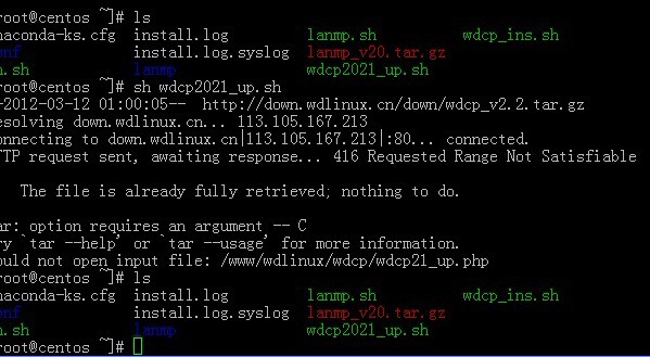

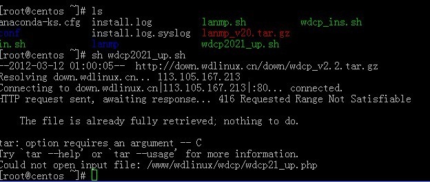

2.12 升級不成功!是不是有什么問題 升級包
圖片附件: 1.jpg (2012-3-12 01:11, 59.1 KB) / 下載次數(shù) 13180
http://www.ahbydz.com/bbs/attachment.php?aid=413&k=603d31942474997c5253c1993fde0835&t=1744743860&sid=SIb6xl
圖片附件: 2.jpg (2012-3-12 01:11, 69.67 KB) / 下載次數(shù) 13140
http://www.ahbydz.com/bbs/attachment.php?aid=414&k=3168bf2a76d253a08206eb9bc1f03662&t=1744743860&sid=SIb6xl
作者: admin    時(shí)間: 2012-3-12 08:53
是打少了個(gè)字符,已修復(fù)

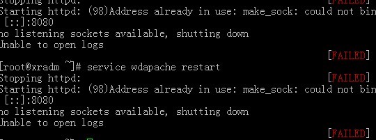

我這個(gè)升級哪的問題,搞不定了,幫看看,多謝。
[root@west13349 data]# cd /
[root@west13349 /]# cd data
[root@west13349 data]# ls -a
.  ..  dx1520120219.tar.gz  mysql  mysql.tar.gz  var  webmysql20120220.tar.gz
[root@west13349 data]# wget http://down.wdlinux.cn/down/wdcp2021_up.sh
--2012-03-12 18:46:12--  http://down.wdlinux.cn/down/wdcp2021_up.sh
正在解析主機(jī) down.wdlinux.cn... 113.105.167.213
Connecting to down.wdlinux.cn|113.105.167.213|:80... 已連接。
已發(fā)出 HTTP 請求,正在等待回應(yīng)... 200 OK
長度:290 [application/octet-stream]
Saving to: `wdcp2021_up.sh'
100%[=====================================================================================>] 290         --.-K/s   in 0s
2012-03-12 18:46:12 (20.8 MB/s) - `wdcp2021_up.sh' saved [290/290]
[root@west13349 data]# sh wdcp2021_up.sh
tar: 從成員名中刪除開頭的“/”
/www/wdlinux/mysql/var/wdcpdb/
/www/wdlinux/mysql/var/wdcpdb/wd_group.MYD
/www/wdlinux/mysql/var/wdcpdb/wd_conf.MYD
/www/wdlinux/mysql/var/wdcpdb/wd_ftp.frm
/www/wdlinux/mysql/var/wdcpdb/wd_group.MYI
/www/wdlinux/mysql/var/wdcpdb/wd_mysql.frm
/www/wdlinux/mysql/var/wdcpdb/wd_member.MYI
/www/wdlinux/mysql/var/wdcpdb/wd_mysql.MYD
/www/wdlinux/mysql/var/wdcpdb/wd_optlog.MYI
/www/wdlinux/mysql/var/wdcpdb/wd_optlog.MYD
/www/wdlinux/mysql/var/wdcpdb/wd_loginlog.MYI
/www/wdlinux/mysql/var/wdcpdb/wd_site.MYD
/www/wdlinux/mysql/var/wdcpdb/wd_optlog.frm
/www/wdlinux/mysql/var/wdcpdb/wd_loginlog.frm
/www/wdlinux/mysql/var/wdcpdb/wd_ftp.MYD
/www/wdlinux/mysql/var/wdcpdb/wd_loginlog.MYD
/www/wdlinux/mysql/var/wdcpdb/wd_ftp.MYI
/www/wdlinux/mysql/var/wdcpdb/wd_group.frm
/www/wdlinux/mysql/var/wdcpdb/wd_conf.MYI
/www/wdlinux/mysql/var/wdcpdb/wd_member.frm
/www/wdlinux/mysql/var/wdcpdb/wd_conf.frm
/www/wdlinux/mysql/var/wdcpdb/wd_site.frm
/www/wdlinux/mysql/var/wdcpdb/wd_member.MYD
/www/wdlinux/mysql/var/wdcpdb/wd_mysql.MYI
/www/wdlinux/mysql/var/wdcpdb/db.opt
/www/wdlinux/mysql/var/wdcpdb/wd_site.MYI
--2012-03-12 18:46:31--  http://down.wdlinux.cn/down/wdcp_v2.2.tar.gz
長度:1049379 (1.0M) [application/octet-stream]
Saving to: `wdcp_v2.2.tar.gz'
100%[=====================================================================================>] 1,049,379   1.19M/s   in 0.8s
2012-03-12 18:46:37 (1.19 MB/s) - `wdcp_v2.2.tar.gz' saved [1049379/1049379]
www/wdlinux/wdcp/
www/wdlinux/wdcp/templates/member/email.htm
www/wdlinux/wdcp/templates/member/group_edit.htm
www/wdlinux/wdcp/templates/member/member_search.htm
www/wdlinux/wdcp/templates/member/chgpasswd.htm
www/wdlinux/wdcp/templates/member/member_list.htm
www/wdlinux/wdcp/templates/vhost/_notes/
www/wdlinux/wdcp/templates/vhost/_notes/dwsync.xml
www/wdlinux/wdcp/templates/vhost/rewrite.htm
www/wdlinux/wdcp/templates/ftp/
www/wdlinux/wdcp/templates/ftp/edit.htm
www/wdlinux/wdcp/templates/ftp/chgpw.htm
www/wdlinux/wdcp/templates/ftp/list.htm
www/wdlinux/wdcp/templates/ftp/_notes/
www/wdlinux/wdcp/templates/ftp/_notes/dwsync.xml
www/wdlinux/wdcp/templates/ftp/add.htm
www/wdlinux/wdcp/data/
www/wdlinux/wdcp/data/.htaccess
tar: www/wdlinux/wdcp/data/.htaccess:時(shí)間戳 2013-07-25 22:51:40 是將來的 43214703 秒之后
www/wdlinux/wdcp/data/tmp/
www/wdlinux/wdcp/data/tmp/.htaccess
www/wdlinux/wdcp/data/ver.php
www/wdlinux/tools/
www/wdlinux/tools/mysql_root_chg.sh
www/wdlinux/tools/pureftp_conf_check.sh
www/wdlinux/tools/wdcp_login_chp.sh
www/wdlinux/tools/wdcp_perm_check.sh
(98)Address already in use: make_sock: could not bind to address 0.0.0.0:8080
no listening sockets available, shutting down
Unable to open logs
wdcp update is OK
然后再打開控制面板,就黃了
作者: admin    時(shí)間: 2012-3-12 19:10
service wdapache restart
看下

作者: yxll    時(shí)間: 2012-3-13 08:51
看下
admin 發(fā)表于 2012-3-12 19:10
