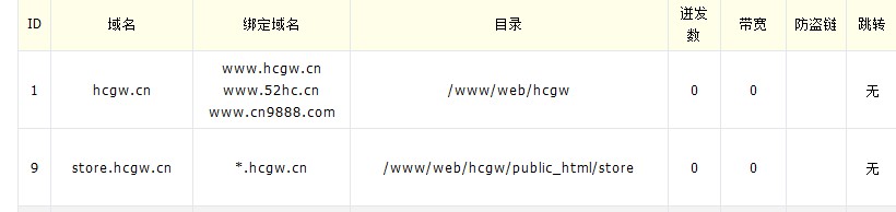

作者: andy15703166    時(shí)間: 2012-8-12 07:48
本帖最后由 andy15703166 于 2012-8-12 07:49 編輯
給你看一下我的配置文件吧:

我的store(company)二級(jí)域名的站點(diǎn)apahce配置文件為
  1. <VirtualHost *:88>
  2. DocumentRoot /www/web/hcgw/public_html/store/
  3. ServerName hcgw.cn
  4. ServerAlias *.hcgw.cn
  5. ErrorDocument 400 /errpage/400.html
  6. ErrorDocument 403 /errpage/403.html
  7. ErrorDocument 404 /errpage/404.html
  8. ErrorDocument 405 /errpage/405.html
  9. php_admin_value open_basedir /www/web/hcgw/public_html:/tmp
  10. <IfModule mod_deflate.c>
  11. DeflateCompressionLevel 7
  12. AddOutputFilterByType DEFLATE text/html text/plain text/xml application/x-httpd-php
  13. AddOutputFilter DEFLATE css js html htm gif jpg png bmp php
  14. </IfModule>
  15. </VirtualHost>
  16. <Directory /www/web/hcgw/public_html/>
  17.     Options FollowSymLinks
  18.     AllowOverride All
  19.     Order allow,deny
  20.     Allow from all
  21. </Directory>
復(fù)制代碼
我的store(company)二級(jí)域名的站點(diǎn)nginx配置文件為
  1. server {
  2.         listen       80;
  3.         server_name *.hcgw.cn;
  4.         root /www/web/hcgw/public_html/store;
  5.         index  index.html index.php index.htm;
  6.         error_page  400 /errpage/400.html;
  7.         error_page  403 /errpage/403.html;
  8.         error_page  404 /errpage/404.html;
  9.         error_page  405 /errpage/405.html;
  10.         location ~ \.php$ {
  11.                 proxy_pass http://127.0.0.1:88;
  12.                 include naproxy.conf;
  13.         }
  14.         location / {
  15.                 try_files $uri @apache;
  16.         }
  17.         location @apache {
  18.                  proxy_pass http://127.0.0.1:88;
  19.                  include naproxy.conf;
  20.         }
  21. }
復(fù)制代碼
