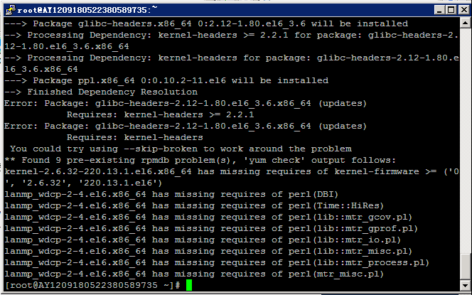

作者: wapsos    時(shí)間: 2012-12-23 23:32
回復(fù) 1# admin
圖片附件: error3.png (2012-12-23 23:32, 26.09 KB) / 下載次數(shù) 10513
http://www.ahbydz.com/bbs/attachment.php?aid=2262&k=66c52c11f5473de388ab0a85ae8f4529&t=1746112124&sid=AiM70V
