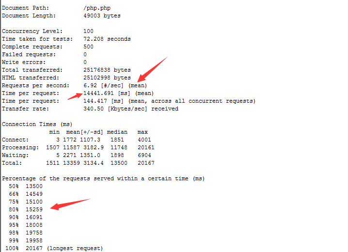

求指導(dǎo)優(yōu)化~~~~~~~~~~
圖片附件: QQ圖片20150117011359.png (2015-1-17 01:37, 26.57 KB) / 下載次數(shù) 6952

# apache conf conf/httpd-wdl.conf
# Created by http://www.ahbydz.com
# Last Updated 2010.06.01
Timeout 30
KeepAlive On
MaxKeepAliveRequests 100
KeepAliveTimeout 3
UseCanonicalName Off
ServerTokens Prod
ServerSignature Off
HostnameLookups Off
AddType application/x-httpd-php .php
DirectoryIndex index.html index.php index.htm
<IfModule mpm_prefork_module>
    ServerLimit         1000
    StartServers          50
    MinSpareServers      100
    MaxSpareServers      200
    MaxClients          1000
    MaxRequestsPerChild 5000
</IfModule>
已經(jīng)把httpd-wdl.conf修改為這個(gè)了
