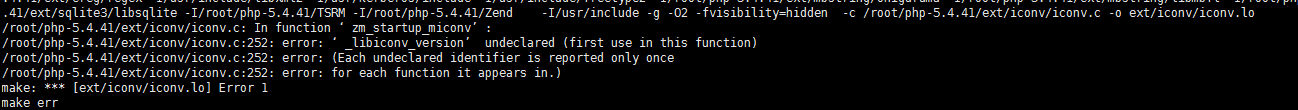

PHP5.3  升級 最新PHP5.4.41 的問題
/root/php-5.4.41/ext/iconv/iconv.c: In function ‘zm_startup_miconv’:
/root/php-5.4.41/ext/iconv/iconv.c:252: error: ‘_libiconv_version’ undeclared (first use in this function)
/root/php-5.4.41/ext/iconv/iconv.c:252: error: (Each undeclared identifier is reported only once
/root/php-5.4.41/ext/iconv/iconv.c:252: error: for each function it appears in.)
make: *** [ext/iconv/iconv.lo] Error 1
make err

我也出現(xiàn)和你一樣的情況,摸索了幾天 終于搞定了
如果你的iconv安裝正常的話,你只要把php_up54.sh 里面的--with-iconv=/usr 改成--with-iconv-dir=/usr  有兩處。
