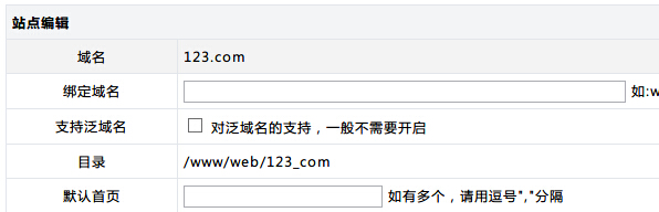

Ŀ䛠 /www/web/123_com
°Ñwordpress Îļþ¶¼·Åµ½ÁË  /www/web/123_com/public_html/ÏÂ
µ«ÊÇ ÓÃIP ´òé_(k¨¡i) ߀ÊÇ¡±¹§Ï²£¬lanmp_wdcp °²Ñb³É¹¦!¡±µÄí“(y¨¨)Ãæ
ÓÃhttp://IP/wp-admin/install.php ¾ÍÌáʾ
Not Found
The requested URL /wp-admin/install.php was not found on this server.
×îºó °Ñwordpress Îļþ¶¼·Åµ½ÁË  /www/web/default/Ï ݔÈëIP ²ÅÄÜ´òé_(k¨¡i)°²Ñbí“(y¨¨)Ãæ
ÊDz»ÊÇ ÎÒÄÇ‚€(g¨¨)ÔO(sh¨¨)ÖÃŪåe(cu¨°)ÁË Œ§(d¨£o)ÖÂÒ»Ö±Ö¸Ïò defaultµÄÕ¾üc(di¨£n)ƒÈ(n¨¨i)ÈÝ Ÿo(w¨²)·¨ÇГQµ½ÐÂÌí¼ÓµÄ123_comƒÈ(n¨¨i)ÈÝÀ
Çó´óÉñŽÍæָüc(di¨£n) ÖxÖxÁË£¡

×÷Õß: xuandun    •r(sh¨ª)ég: 2015-6-26 22:42
„hµôindex.htmlÔ‡Ô‡
×÷Õß: wukingp    •r(sh¨ª)ég: 2016-10-19 12:03
ÄãºÃ£¬Õˆ(q¨«ng)†–(w¨¨n)ÄãµÄ¸ã¶¨Áˆá£¿ÎÒÒ²Åöµ½ß@˜ÓµÄÇé›r£¬¶øÇÒÎÒÒѽ›(j¨©ng)°Ñindex.htmlÏàêP(gu¨¡n)µÄ¶¼„h³ýÁË£¬¶¼ÊÇï@ʾÓÃhttp://IP/wp-admin/install.php ¾ÍÌáʾ
Not Found
