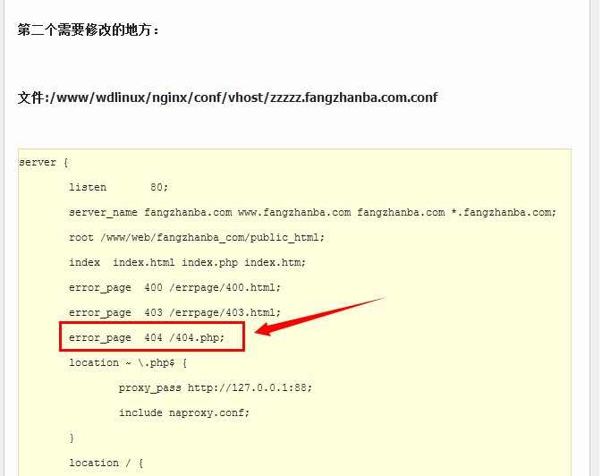

wdos一鍵安裝版,用的nginx,是這樣改嗎:
/www/wdlinux/nginx-1.0.15/conf/vhost/site_name.conf
server {
        listen       80;
        server_name site_name;
        root /www/web/site_name/public_html;
        index index.php index.htm;
        error_page  400 /errpage/400.html;
        error_page  403 /errpage/403.html;
        error_page  404 /errpage/404.php;  #這里就可以了?
        error_page  405 /errpage/405.html;
        location ~ \.php$ {
                fastcgi_pass   127.0.0.1:9000;
                fastcgi_index  index.php;
                include fcgi.conf;

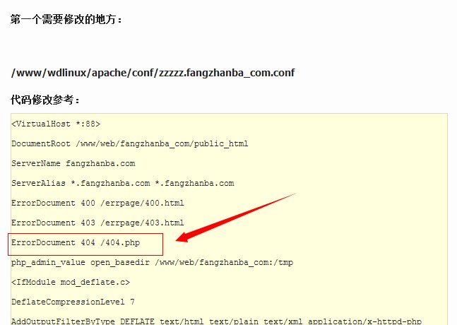

作者: hanfei    時(shí)間: 2014-7-11 21:52
圖片附件: 001.jpg (2014-7-11 21:51, 51.57 KB) / 下載次數(shù) 13794
http://www.ahbydz.com/bbs/attachment.php?aid=4672&k=36389aade22c9dd8ac9a8e47cd87f736&t=1747074679&sid=xuf1RX
圖片附件: 002.jpg (2014-7-11 21:52, 53.33 KB) / 下載次數(shù) 13781
http://www.ahbydz.com/bbs/attachment.php?aid=4673&k=f3ed1f1c41d30486dadc3ccef62bc1aa&t=1747074679&sid=xuf1RX
作者: hanfei    時(shí)間: 2014-7-11 21:53
回復(fù) 1# hjc91
圖片附件: 001.jpg (2014-7-11 21:52, 51.57 KB) / 下載次數(shù) 13818
http://www.ahbydz.com/bbs/attachment.php?aid=4674&k=236b6b2b691a5fa2e7fa967e65d3342e&t=1747074679&sid=xuf1RX
圖片附件: 002.jpg (2014-7-11 21:52, 53.33 KB) / 下載次數(shù) 13820
http://www.ahbydz.com/bbs/attachment.php?aid=4675&k=b6f2f8d783e723e73c078905476a4333&t=1747074679&sid=xuf1RX
