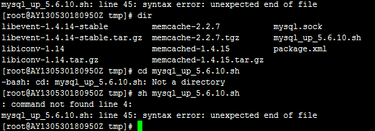

作者: guoyin    時(shí)間: 2013-6-1 17:53
安裝出錯(cuò)呀
作者: guoyin    時(shí)間: 2013-6-1 17:54
我是在WIN7解壓后在上傳到TMP 執(zhí)行的
圖片附件: QQ截圖20130601174821.png (2013-6-1 17:54, 9.43 KB) / 下載次數(shù) 16249
http://www.ahbydz.com/bbs/attachment.php?aid=3052&k=03087f7df17766863d0cc35ad3bf48a3&t=1747074233&sid=5m0Kzv
作者: guoyin    時(shí)間: 2013-6-1 21:52
[root@AY130530180950Z ~]# sh mysql_up_5.6.10.sh
mysql_up_5.6.10.sh: line 50: syntax error: unexpected end of file
You have new mail in /var/spool/mail/root
提示錯(cuò)誤升級(jí)不了
