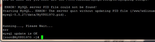

wget http://down.wdlinux.cn/in/mysql_up55.sh
sh mysql_up55.sh我是按著這個升級的 是面板安裝好后
升級的
詳細(xì)的錯誤日志
130228 23:33:43 [Note] Server hostname (bind-address): '0.0.0.0'; port: 3306
130228 23:33:43 [Note]   - '0.0.0.0' resolves to '0.0.0.0';
130228 23:33:43 [Note] Server socket created on IP: '0.0.0.0'.
130228 23:33:43 [ERROR] Fatal error: Can't open and lock privilege tables: Table 'mysql.host' doesn't exist
130228 23:33:43 mysqld_safe mysqld from pid file /www/wdlinux/mysql-5.5.27/data/MyVPS1970.pid ended
圖片附件: QQ截圖20130228232600.jpg (2013-2-28 23:28, 30.33 KB) / 下載次數(shù) 18816
http://www.ahbydz.com/bbs/attachment.php?aid=2481&k=9d6e75927ede11335b1eff293c52d067&t=1744028571&sid=NqgkKd
