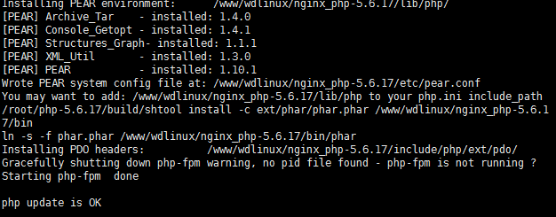

升級(jí)PHP 版本到:5.6.16
下載php5.6.sh
上傳到root目錄下。如:/root/php5.6.sh
執(zhí)行以下命令:
      sh php5.6.sh

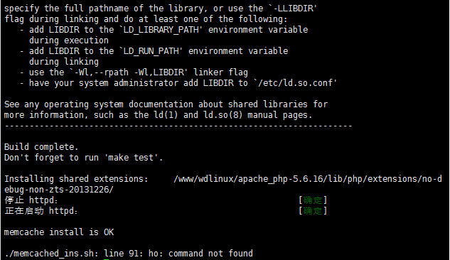

安裝memcached數(shù)據(jù)庫(kù)緩存擴(kuò)展下載memcached.sh
      上傳到root目錄下。如:/root/memcached.sh
     執(zhí)行以下命令:
    sh memcached.sh
一步到位

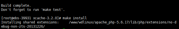

安裝XCache 3.2.0、PHP緩存擴(kuò)展
20140918~XCache 3.2.0 發(fā)布. 增加 PHP_5_6 支持. 詳情參見(jiàn)發(fā)布包內(nèi)的 NEWS 與 ChangeLog 文件
執(zhí)行以下命令:(全部)
wget http://xcache.lighttpd.net/pub/Releases/3.2.0/xcache-3.2.0.tar.gz
tar -zxvf xcache-3.2.0.tar.gz
cd xcache-3.2.0
/www/wdlinux/php/bin/phpize
./configure -with-php-config=/www/wdlinux/php/bin/php-config -enable-xcache -enable-xcache-coverager -enable-inline-optimization -disable-debug
make
make install
一步到位
重啟服務(wù)service httpd restart

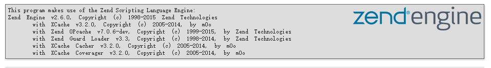

安裝完成后php.ini
[Zend Opcache]
zend_extension= /www/wdlinux/php/lib/php/extensions/no-debug-non-zts-20131226/opcache.so
opcache.memory_consumption=64
opcache.interned_strings_buffer=8
opcache.max_accelerated_files=4000
opcache.force_restart_timeout=180
opcache.revalidate_freq=60
opcache.fast_shutdown=1
opcache.enable_cli=1
[Zend]
zend_extension = /www/wdlinux/Zend/lib/ZendGuardLoader.so
zend_loader.enable=1
zend_loader.disable_licensing=0
zend_loader.obfuscation_level_support=3
[memcache]
extension_dir=/www/wdlinux/php/lib/php/extensions/no-debug-non-zts-20131226
extension=memcache.so
[xcache-common]
extension = xcache.so
[xcache]
xcache.shm_scheme = "mmap"
xcache.size = 160M
xcache.count = 1
xcache.slots = 8K
xcache.ttl = 0
xcache.gc_interval = 0
xcache.var_size = 4M
xcache.var_count = 1
xcache.var_slots = 8K
xcache.var_ttl = 0
xcache.var_maxttl = 0
xcache.var_gc_interval = 300
xcache.var_namespace_mode = 0
xcache.var_namespace = ""
xcache.readonly_protection = Off
xcache.mmap_path = "/tmp/xcache"
xcache.coredump_directory = ""
xcache.coredump_type = 0
xcache.disable_on_crash = Off
xcache.experimental = Off
xcache.cacher = On
xcache.stat = On
xcache.optimizer = Off
[xcache.coverager]
xcache.coverager = Off
xcache.coverager_autostart = On
xcache.coveragedump_directory = ""
