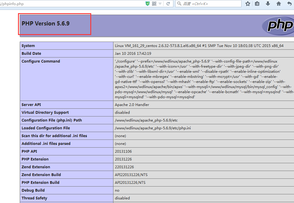

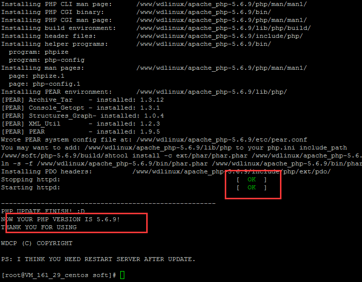

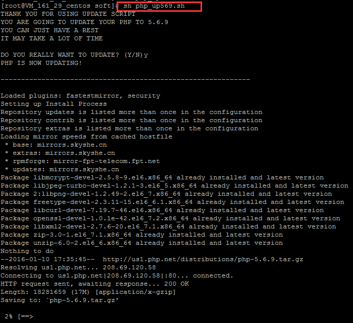

開始,就兩步:
   1,執(zhí)行:  wget http://92lp-10003241.file.myqcloud.com/php_up569.sh  (如果失效就下載帖子下面的附件)
   2,執(zhí)行: sh php_up569.sh
看到上圖的version is 5.6.9 說明升級成功了.
