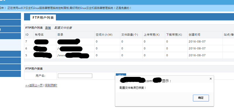

作者: yanfei0429    時間: 2016-8-7 15:17
圖片附件: clipboard.png (2016-8-7 15:17, 62.24 KB) / 下載次數(shù) 11921
http://www.ahbydz.com/bbs/attachment.php?aid=6501&k=cea4d112503088ed42e966d5c600b7cd&t=1746848152&sid=K4h8S8
