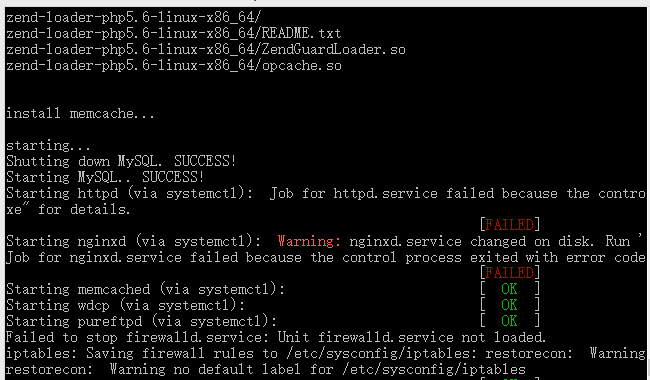

作者: seedcard    時(shí)間: 2016-4-27 14:59
本帖最后由 seedcard 于 2016-4-27 15:26 編輯
回復(fù) 3# admin
我剛在一臺(tái)centos的主機(jī)上測(cè)試,問題依舊,訪問不了默認(rèn)目錄
重裝,最后有提醒
Starting nginxd (via systemctl):  Warning: nginxd.service changed on disk. Run 'systemctl daemon-reload' to reload units.
Job for nginxd.service failed because the control process exited with error code. See "systemctl status nginxd.service" and "journalctl -xe" for details.

作者: admin    時(shí)間: 2016-4-27 16:08
修改過哪?
重起試試
