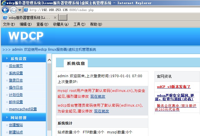

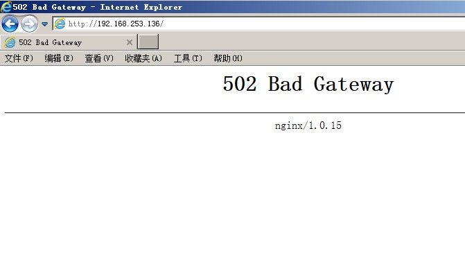

作者: nqsu    時間: 2016-8-24 21:39     標題: 用以前2.5的sh腳本安裝 打開ip502錯誤 后臺能進

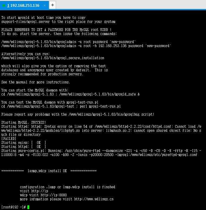

Setting up Install Process
Package 1:make-3.81-23.el6.i686 already installed and latest version
Package autoconf-2.63-5.1.el6.noarch already installed and latest version
Package sudo-1.8.6p3-24.el6.i686 already installed and latest version
Package wget-1.12-8.el6.i686 already installed and latest version
Package libtool-ltdl-devel-2.2.6-15.5.el6.i686 already installed and latest version
Package gd-devel-2.0.35-11.el6.i686 already installed and latest version
Package freetype-devel-2.3.11-17.el6.i686 already installed and latest version
Package libxml2-devel-2.7.6-21.el6_8.1.i686 already installed and latest version
Package libjpeg-turbo-devel-1.2.1-3.el6_5.i686 already installed and latest version
Package 2:libpng-devel-1.2.49-2.el6_7.i686 already installed and latest version
Package openssl-devel-1.0.1e-48.el6_8.1.i686 already installed and latest version
Package libcurl-devel-7.19.7-52.el6.i686 already installed and latest version
Package patch-2.6-6.el6.i686 already installed and latest version
No package libmcrypt-devel available.
No package libmhash-devel available.
Package ncurses-devel-5.7-4.20090207.el6.i686 already installed and latest version
Package iptables-1.4.7-16.el6.i686 already installed and latest version
Nothing to do
--2016-08-25 05:32:01--  http://dl.wdlinux.cn:5180/soft/rpmforge-release-0.5.2-2.el6.rf.i686.rpm
Resolving dl.wdlinux.cn... 222.186.61.177
Connecting to dl.wdlinux.cn|222.186.61.177|:5180... connected.
HTTP request sent, awaiting response... 200 OK
Length: 12732 (12K) [text/plain]
Saving to: “rpmforge-release-0.5.2-2.el6.rf.i686.rpm”
100%[=================================================================>] 12,732      --.-K/s   in 0.08s
2016-08-25 05:32:02 (148 KB/s) - “rpmforge-release-0.5.2-2.el6.rf.i686.rpm” saved [12732/12732]
warning: rpmforge-release-0.5.2-2.el6.rf.i686.rpm: Header V3 DSA/SHA1 Signature, key ID 6b8d79e6: NOKEY
Preparing...                ########################################### [100%]
   1:rpmforge-release       ########################################### [100%]
Loaded plugins: fastestmirror
Could not retrieve mirrorlist http://apt.sw.be/redhat/el6/en/mirrors-rpmforge error was
14: PYCURL ERROR 22 - "The requested URL returned error: 404 Not Found"
* base: mirrors.163.com
* extras: mirrors.163.com
* updates: centos.ustc.edu.cn
http://apt.sw.be/redhat/el6/en/i386/rpmforge/repodata/repomd.xml: [Errno 14] PYCURL ERROR 22 - "The requested URL returned error: 404 Not Found"
Trying other mirror.
Error: Cannot retrieve repository metadata (repomd.xml) for repository: rpmforge. Please verify its path and try again
--2016-08-25 05:32:04--  http://dl.wdlinux.cn:5180/rpms/lanmp_wdcp-2-5.el6.i386.rpm
Length: 90711430 (87M) [text/plain]
Saving to: “l(fā)anmp_wdcp-2-5.el6.i386.rpm”
100%[=================================================================>] 90,711,430   820K/s   in 2m 0s
2016-08-25 05:34:04 (741 KB/s) - “l(fā)anmp_wdcp-2-5.el6.i386.rpm” saved [90711430/90711430]
   1:lanmp_wdcp             ########################################### [100%]
Installing MySQL system tables...
OK
Filling help tables...
OK
To start mysqld at boot time you have to copy
support-files/mysql.server to the right place for your system
PLEASE REMEMBER TO SET A PASSWORD FOR THE MySQL root USER !
To do so, start the server, then issue the following commands:
/www/wdlinux/mysql-5.1.63/bin/mysqladmin -u root password 'new-password'
/www/wdlinux/mysql-5.1.63/bin/mysqladmin -u root -h 192.168.253.136 password 'new-password'
Alternatively you can run:
/www/wdlinux/mysql-5.1.63/bin/mysql_secure_installation
which will also give you the option of removing the test
databases and anonymous user created by default.  This is
strongly recommended for production servers.
See the manual for more instructions.
You can start the MySQL daemon with:
cd /www/wdlinux/mysql-5.1.63 ; /www/wdlinux/mysql-5.1.63/bin/mysqld_safe &
You can test the MySQL daemon with mysql-test-run.pl
cd /www/wdlinux/mysql-5.1.63/mysql-test ; perl mysql-test-run.pl
Please report any problems with the /www/wdlinux/mysql-5.1.63/bin/mysqlbug script!
Starting MySQL. SUCCESS!
Starting httpd: httpd: Syntax error on line 54 of /www/wdlinux/httpd-2.2.22/conf/httpd.conf: Cannot load /www/wdlinux/httpd-2.2.22/modules/libphp5.so into server: libmhash.so.2: cannot open shared object file: No such file or directory
[FAILED]
Starting nginx: [  OK  ]
Starting httpd: [  OK  ]
Starting pure-config.pl: Running: /usr/sbin/pure-ftpd --daemonize -S21 -A -c50 -B -C8 -D -E -fftp -H -I15 -L10000:8 -m4 -s -U133:022 -u100 -k99 -Z -lunix -p20000:20500 -lmysql:/www/wdlinux/etc/pureftpd-mysql.conf
============  lanmp_wdcp install OK  ==============
          configuration ,lamp or lnmp,wdcp install is finshed
          visit http://ip
          wdcp visit http://ip:8080
          more infomation please visit http://www.ahbydz.com
[root@192 ~]#

作者: nqsu    時間: 2016-8-24 21:40
在多臺機子/vps 測試過  就最近幾天出現(xiàn)這樣的情況  @admin
作者: nqsu    時間: 2016-8-26 13:45
頂一下   @admin
作者: d8b1    時間: 2016-8-28 02:36
一樣的情況
作者: kuangxianwei    時間: 2016-9-8 09:39
你們是安裝了centos 6.x 的版本,目前我遇到這樣的問題,然后我安裝centos 5.9 或者5.8 64為版本的完全沒有問題,也就是wdcp升級后不支持centos 6.x
作者: eyou360    時間: 2016-9-12 03:13
重新安裝一下php就可以了
wget http://down.wdlinux.cn/in/php_up53.sh
sh php_up53.sh
看到"php update is OK"提示
表示,順利完成
