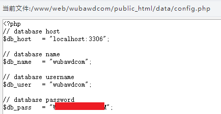

帝國后臺配置參數(shù)恢復(fù)數(shù)據(jù)庫后
Data/config.php數(shù)據(jù)庫配置如下
(6.24 KB)

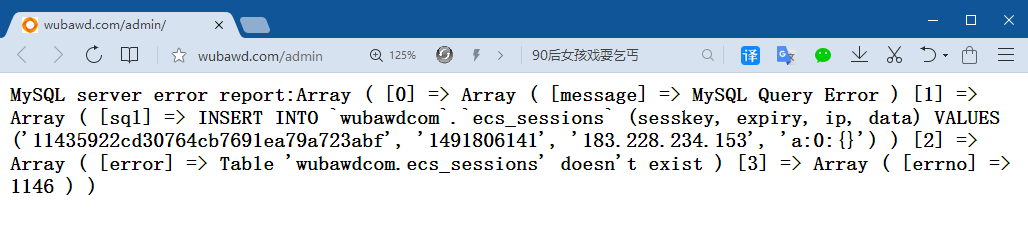

后臺地址http://wubawd.com/admin/打開提示
(26.3 KB)
2017-4-10 15:23

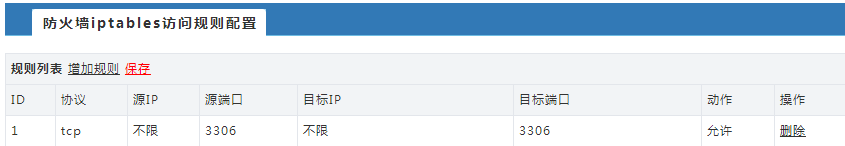

這是WDCP后臺添加的防火墻規(guī)則配置
(7.22 KB)
2017-4-10 15:24

host改為localhost
重啟下mysql

是這樣操作嗎
(1.31 KB)
2017-4-11 19:58
(2.09 KB)
2017-4-11 19:58
(2017-4-11 19:58, 1.31 KB) / 下載次數(shù) 9392
http://www.ahbydz.com/bbs/attachment.php?aid=7208&k=ef9450bb97e6d24116f0aeff03d6bee0&t=1743954718&sid=RYNMJR
(2017-4-11 19:58, 2.09 KB) / 下載次數(shù) 8931
http://www.ahbydz.com/bbs/attachment.php?aid=7209&k=6ab735a9a2ae4f68c44e58261155dd85&t=1743954718&sid=RYNMJR

不是啊,把3306拿掉
