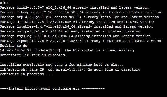

今天剛裝就出現(xiàn)這個(gè)問(wèn)題,小白不懂,下步怎么辦,重裝嗎

lib/mysql.sh: line 29: cd: mysql-5.1.72/: No such file or directory
是不是這個(gè)文件有問(wèn)題啊,好像沒(méi)找到一樣

tar: mysql-5.1.72.tar.gz: Cannot open: No such file or directory
tar: Error is not recoverable: exiting now
lib/mysql.sh: line 32: ./configure: No such file or directory
這個(gè)是日志,剛重裝又是上面的問(wèn)題,實(shí)在不懂那出問(wèn)題了

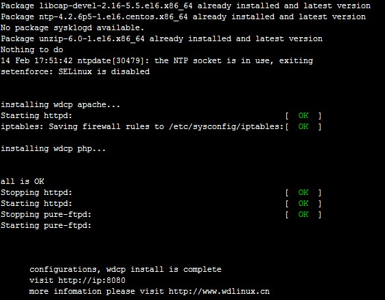

重新下載一次看看

剛開(kāi)始重新安裝,剛才出錯(cuò)的問(wèn)題已經(jīng)沒(méi)有了,樓上的再試一下重裝吧!

感覺(jué)是白天有某個(gè)FTP站出問(wèn)題了…… 沒(méi)下載到MYSQL的安裝包……
